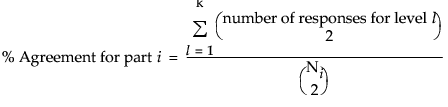

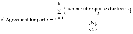

For the first chart in Figure 9.5 that plots all X, Grouping variables on the x-axis, the percent Agreement is calculated as follows:

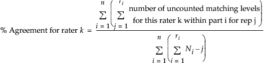

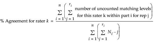

For the second chart in Figure 9.5 that plots all Y, Response variables on the x-axis, the percent Agreement is calculated as follows:
n = number of parts (grouping variables)
ri = number of reps for part i (i = 1,...,n)
m = number of raters
k = number of levels
Ni = m x ri. Number of ratings on part i (i = 1,...,n). This includes responses for all raters, and repeat ratings on a part. For example, if part i is measured 3 times by each of 3 raters, then Ni is 3 x 3 = 9.
