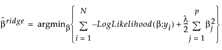

An l2 penalty is applied to the regression coefficients during ridge regression. Ridge regression coefficient estimates are given by the following:
is the l2 penalty, λ is the tuning parameter, N is the number of rows, and p is the number of variables.An l∞ penalty is applied to the regression coefficients during Dantzig Selector. Coefficient estimates for the Dantzig Selector satisfy the following criterion:

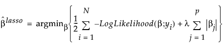

An l1 penalty is applied to the regression coefficients during Lasso. Coefficient estimates for the Lasso are given by the following:

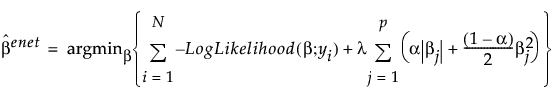

is the l1 penalty, λ is the tuning parameter, N is the number of rows, and p is the number of variablesThe Elastic Net combines both l1 and l2 penalties. Coefficient estimates for the Elastic Net are given by the following:
Tip: There are two sample scripts that illustrate the shrinkage effect of varying α and λ in the Elastic Net for a single predictor. Select Help > Sample Data, click Open the Sample Scripts Directory, and select demoElasticNetAlphaLambda.jsl or demoElasticNetAlphaLambda2.jsl. Each script contains a description of how to use it and what it illustrates.
