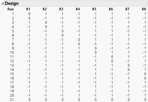

Figure 6.22 shows an example of a definitive design with eight continuous factors. and four Extra Runs that correspond to fake factors. Notice the following:
Figure 6.22 Definitive Screening Design for Eight Continuous Factors

Extra runs are constructed using fictitious, or fake, factors. Adding k1 fake factors to a design results in 2k1 additional runs.
Denote the number of factors in your experimental study by k. Extra runs are constructed by creating a design for k + k1 factors, as described in Conference Matrices and the Number of Runs, and then dropping the last k1 columns. If k1 = 2, four extra runs are added. If k1 = 3, eight extra runs are added. As few as four extra runs can be highly beneficial in model selection.
