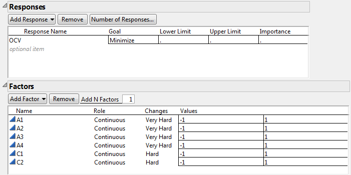

Select DOE > Custom Design.
Double-click Y under Response Name and type OCV.
Under Goal, click Maximize and select Minimize.
To add factors manually, follow step 5 through step 10. Or, to load factors from a saved table:
a.
Select Load Factors from the Custom Design red triangle menu.
b.
Open the Battery Factors.jmp sample data table, located in the Design Experiment folder.
5.
Type 6 next to Add N Factors.
6.
Click Add Factor > Continuous.
7.
Rename the factors A1, A2, A3, A4, C1, and C2.
8.
For each of the factors A1, A2, A3, and A4, under Changes, click Easy and change it to Very Hard.
9.
For each of the factors C1 and C2, under Changes, click Easy and change it to Hard.
Figure 4.76 Responses and Factors Outlines

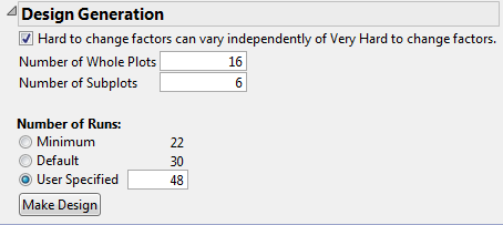

In the Design Generation outline, select the option Hard to change factors can vary independently of Very Hard to change factors.
See Figure 4.77. Checking this option creates a two-way split-plot design. If this option is not checked, the design is treated as a split-split-plot design, with nesting of factors at the two levels.
13.
Type 16 as the Number of Whole Plots.
14.
Type 6 as the Number of Subplots.
Figure 4.77 Design Generation Outline

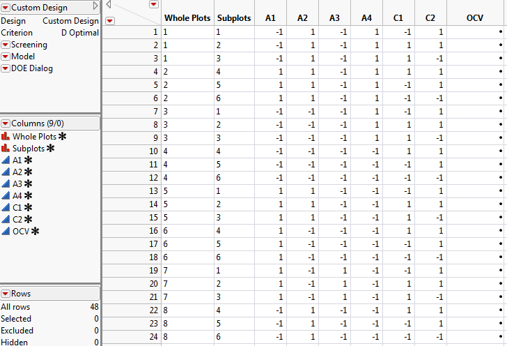

Figure 4.78 Partial View of Design Table
The design table shows 16 levels for Whole Plots. For each level of Whole Plots, the settings of the four assembly factors are constant. From each level of Whole Plots, three batches of 500 batteries (Subplots) are randomly assigned to settings of the curing factors. Two sets of curing conditions are replicated (C1 = -1, C2 = 1 and C1 = 1, C2 = 1). To see this, select columns C1 and C2, right-click in the header area, and select Sort > Ascending.

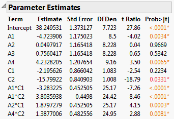

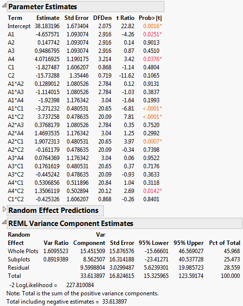

Figure 4.79 Report for Full Model
The Parameter Estimates report indicates that four two-way interactions, A1*C1, A1*C2, A2*C1, and A4*C2, and two main effects, A1 and A4, are significant at the 0.05 level.

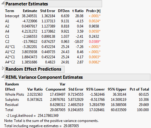

Figure 4.80 Report for Preliminary Reduced Model
Notice that the main effect C2 is now significant at the 0.05 level (Prob>|t| = 0.0331)
The main effect A3 is the only main effect that is not significant and not involved in a two-way interaction.
8.
Click Run.
Figure 4.81 Report for Reduced Model

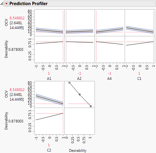

The REML Variance Component Estimates report shows that the variance component associated with Whole Plots is about six times as large as the variance component for Subplots. This suggests that the assembly process is more variable than the curing process. Also, the within (Residual) error is larger than that for Subplots. Efforts to reduce variation should focus on the assembly process and on battery-to-battery differences.
10.
From the red triangle next to Prediction Profiler, select Optimization and Desirability > Maximize Desirability.
Figure 4.82 Prediction Profiler with Settings That Minimize OCV
