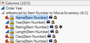

The Columns panel in a data table shows you the names of the linked columns. For example, open the Movie Inventory.jmp and Movie Rentals.jmp sample data tables to see the linked columns shown in Figure 8.7.
The column name of the source column is followed by the name of the referencing column in brackets. For example, Figure 8.7 shows the Name source column followed by the referencing column [Item Number] in brackets.
Figure 8.7 Linked Columns in Movie Rentals.jmp
