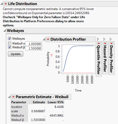

You have no failures (all observations are right-censored) and the preference Weibayes Only for Zero Failure Data is checked. Then the Weibayes report appears. See Weibayes Example for Data with No Failures.
Select Help > Sample Data Library and open Reliability/Weibayes No Failures.jmp.
Select Analyze > Reliability and Survival > Life Distribution.
Select Time and click Y, Time to Event.
Select Censor and click Censor.
5.
Select Freq and click Freq.
6.
Select Likelihood as the Confidence Interval Method.
7.
A special Life Distribution report appears. Weibayes and Weibull beta should be selected.
9.
Click Update.
Figure 2.18 Life Distribution Report for Zero Failures

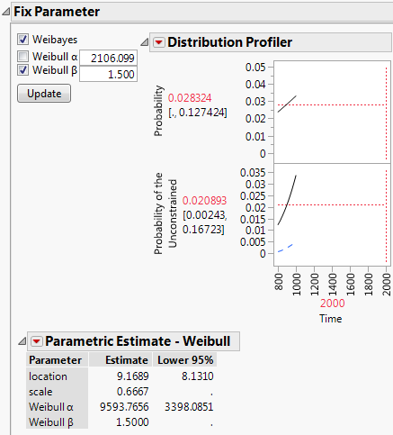

Select Help > Sample Data Library and open Reliability/Weibayes One Failure.jmp.
5.
6.
7.
8.
Select the Weibull distribution in the Compare Distributions plot.
9.
Select Fix Parameter from the Parametric Estimate - Weibull red triangle menu.
10.
Select Weibayes and Weibull beta in the Fix Parameter report.
12.
Click Update.
14.
Place your cursor over the top of the Y axis. The cursor becomes a hand. Drag the axis downward until it reaches 0.5 as the top number.
Figure 2.19 Life Distribution Report for One Failure
