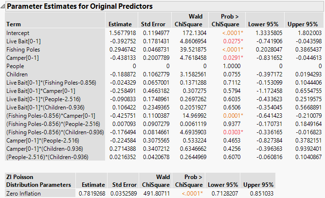

An Adaptive Elastic Net with Validation Column report appears. The Solution Path, the Parameter Estimates for Original Predictors report, and the Effect Tests report indicate that a number of terms are zeroed. The Zero Inflation parameter, whose estimate is shown on the last line of both Parameter Estimates reports, is highly significant. This indicates that some of the variation in the response, Fish Caught, might be due to the fact that some groups did not fish.
The Effect Tests report indicates that five terms are significant at the 0.05 level: Live Bait, Fishing Poles, Camper, Fishing Poles*Camper, and Fishing Poles*Children.
