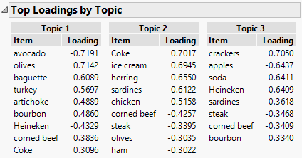

Figure 21.6 Topic Items Report

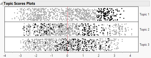

Figure 21.7 Topic Scores

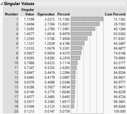

Figure 21.8 Singular Values Table
As seen in Figure 21.8, the first two singular values explain only about 30% of the variability in the grocery store data. Additional dimensions might be required to explain a sufficient amount of variability.
