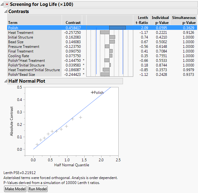

The Weld-Repaired Castings.jmp sample data table uses a Plackett-Burman design, and is found in Box et al. (1978). Seven factors are thought to be influential on weld quality. The seven factors include Initial Structure, Bead Size, Pressure Treatment, Heat Treatment, Cooling Rate, Polish, and Final Treatment. A Plackett-Burman design with 12 runs is used to investigate the importance of the seven factors. The response is
. (The sample data table also contains four terms that were used to model error, but those terms are not used in this analysis.)
. (The sample data table also contains four terms that were used to model error, but those terms are not used in this analysis.)|
Select Analyze > Specialized Modeling > Specialized DOE Models > Fit Two Level Screening.
The seven factors Initial Structure, Bead Size, Pressure Treatment, Heat Treatment, Cooling Rate, Polish, and Final Treatment are specified for X.
Figure 10.6 Screening Report for Weld-Repaired Castings.jmp
The only significant effect identified is Polish. Note that asterisks mark four terms, indicating that they are not orthogonal to the effects preceding them. The contrast values obtained for these effects are after orthogonalization. As a result, these estimates do not match estimates obtained from a corresponding regression analysis. You can use the Run Model button to fit the single-factor model.
