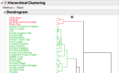

The Hierarchical Clustering report appears. Figure .11 shows a portion of the report. The clusters are colored according to the data table row states.

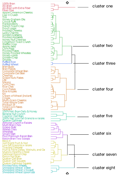

Select Color Clusters from the Hierarchical Clustering red triangle menu.
Figure .12 Colored Clusters
Figure .13 Similar Cereals in Cluster One

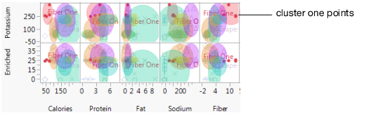

Figure .14 Selecting a Cluster
5.

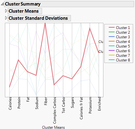

To see the similar characteristics in the cluster, select Cluster Summary from the red triangle menu.
Figure .15 Cluster Summary
Figure .16 Cluster One Characteristics
