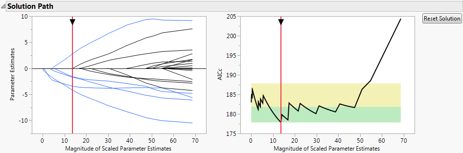

An Adaptive Elastic Net with AICc Validation report appears. The Solution Path is shown in Figure 7.3.
Figure 7.3 Solution Path Plot
9.
Click the red triangle next to Adaptive Elastic Net with AICc Validation and select the Select Zeroed Terms option.

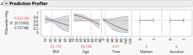

Click the red triangle next to Adaptive Elastic Net with AICc Validation and select Profilers > Profiler.
Note: The predictor Hepatitis is not shown in the profiler because it does not appear in any active (nonzero) terms. Because Markers and Jaundice appear in active interaction terms, they appear in the profiler even though, as main effects, they are not active.
11.

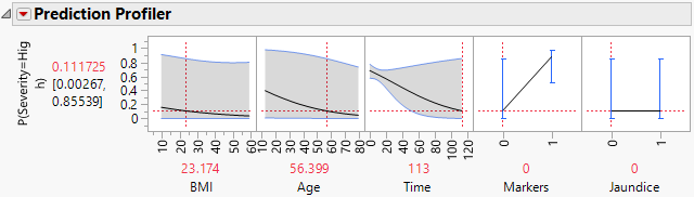

Move the red dashed line for Time from left to right to see its interaction with Markers (Figure 7.4 and Figure 7.5). For patients who enter the study with small values of Time since diagnosis, Markers have little impact on Severity. But for patients who enter the study having been diagnosed for a longer time, Markers are important. For those patients, normal markers suggest a lower probability of high Severity.
