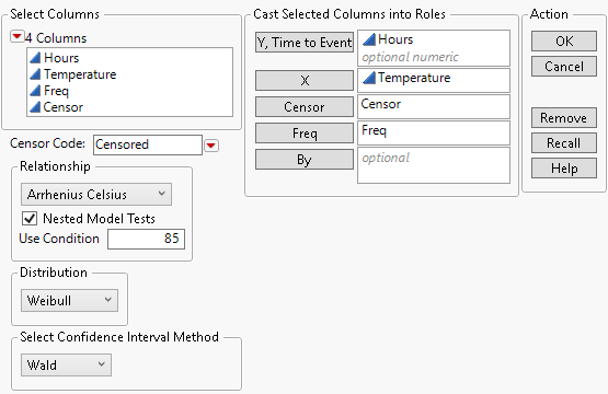

Select Weibull as the distribution.
10.
Keep Wald as the confidence interval method.
Figure 4.22 shows the completed launch window.
Figure 4.22 Fit Life by X Launch Window

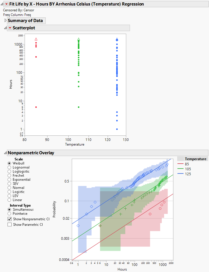

Figure 4.23 shows the top half of the Fit Life by X report window.
