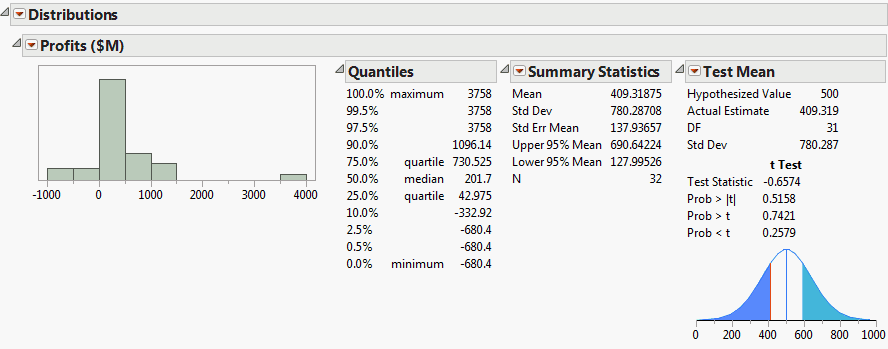

Select Analyze > Distribution to open the Distribution launch window.
Click OK.
5.
From the red triangle menu next to Distributions, select Stack to make your report horizontal.
6.
From the red triangle menu next to Profits ($M), deselect Outlier Box Plot to turn the option off.
7.
8.
Type 500 in the Specify Hypothesized Mean box.
9.
Click OK.
Figure 3.1 Customized Distribution Report

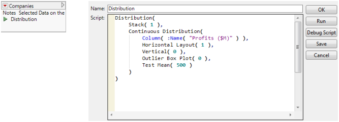

From the red triangle menu next to Distributions, select Save Script > To Data Table.
Your data table now has a script named Distribution saved to it. Right-click the Distribution script and select Edit to see the script.
Figure 3.2 Distribution Script Saved to the Data Table
