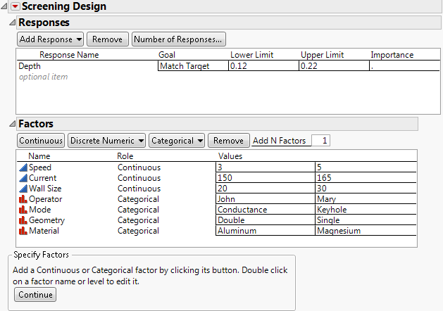

Type 3 in the Add N Factors box and click Continuous.
Double-click X1 and type Speed.
a.
Change the Speed values to 3 and 5.
b.
Change X2 to Current, with values of 150 and 165.
c.
Change X3 to Wall Size, with values of 20 and 30.
Type 4 in the Add N Factors box and select Categorical > 2 Level.
5.
Double-click X4 and type Operator.
a.
Change the Operator values to John and Mary.
b.
Change X5 to Mode, with values of Conductance and Keyhole.
c.
Change X6 to Geometry, with values of Double and Single.
d.
Change X7 to Material, with values of Aluminum and Magnesium.
Figure 9.2 Responses and Factors Outlines for Weld Experiment

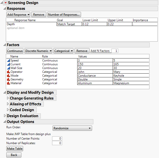

Click Continue.
In the Output Options outline, note that Run Order is set to Randomize. This means that the design runs will appear in random order. This is the order you should use to conduct your experimental runs.
Figure 9.4 Completed Screening Design Window

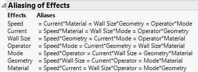

Figure 9.5 Aliasing for an Eight-Run Fractional Factorial Design
Recall that you selected a Resolution 3 design (see Figure 9.3). In a Resolution 3 design, some main effects are confounded with two-way interactions. The Aliasing of Effects outline indicates that, for this Resolution 3 design, every main effect is completely confounded with three two-way interactions. If you suspect that two-way interactions are active, this is a poor design. For a description of confounding, see Two-Level Regular Fractional Factorial.

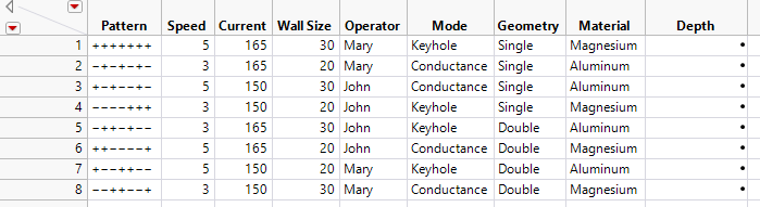

Click Make Table.
Figure 9.6 The Design Data Table
The Pattern column shows the assignment of high and low settings for the design runs.

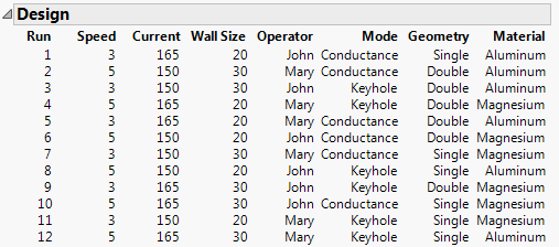

In the Choose Screening Type panel, select the Construct a main effects screening design option.
7.
Click Continue.
Under Number of Runs, the selected option is Default with the number of runs set to 12. Keep this setting.
8.
Click Make Design.
Figure 9.7 Main Effects Screening Design

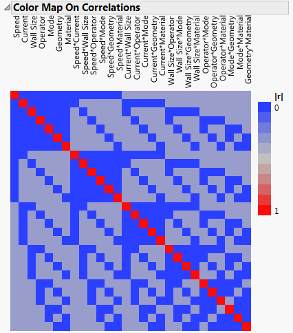

Figure 9.8 Color Map on Correlations for 12-Run Main Effects Screening Design
