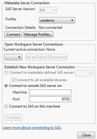

To begin, select File > SAS > Server Connections. The SAS Server Connections window shown in Figure 3.14 appears. All connections are made in this window.
Figure 3.14 SAS Server Connections
Select File > SAS > Server Connections. The SAS Server Connections window shown in Figure 3.14 appears.
Click Connect.

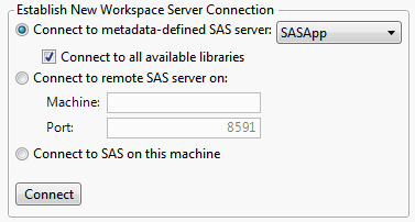

Figure 3.15 Open a Connection to a Workspace Server
Click Connect.
Under Open Workspace Server Connections, the Workspace Server is shown as the current active connection. See Figure 3.16.

In the SAS Server Connections window, select the SAS Server Version.
Click Manage Profiles.

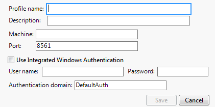

Figure 3.17 Create or Modify a Metadata Server Profile
The name of the machine that hosts the Metadata Server. (Example: myserver.mycompany.com)
5.
Click Save.

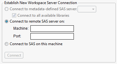

You can also connect directly to a SAS Workspace Server, instead of going through a Metadata Server.
Under Establish New Workspace Server Connection, select Connect to remote SAS server on. See Figure 3.18.
Figure 3.18 Open a Connection to a Remote SAS Server
Click Connect.
6.
Click OK.
