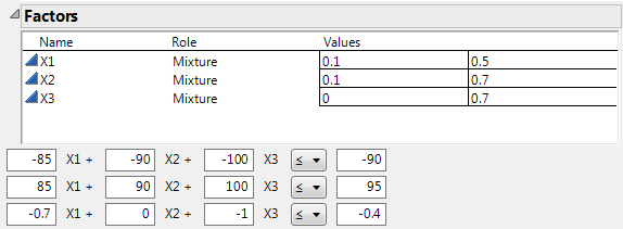

In the Table panel, click the green triangle next to the DOE Dialog script.
Figure A.35 Linear Constraints beneath Factors Outline
Type 85 next to X1.
Type 90 next to X2.
Type 100 next to X3.
Select ≥ from the inequality menu.

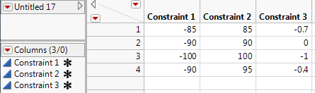

Select Save Constraints from the Mixture Design red triangle menu.
Figure A.36 Constraint Table
Each column contains the coefficients of the factors X1, X2, and X3 in rows 1 through 3. Row 4 contains the value that appeared to the right of the inequality sign.
5.
Click the asterisk next to Constraint 1.

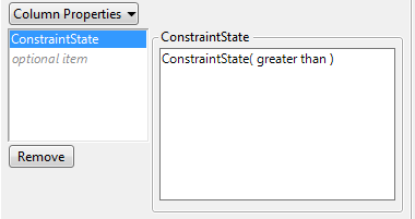

Click ConstraintState.
Figure A.37 ConstraintState Column Property Panel
The ConstraintState panel for X1 indicates that the direction of the inequality is “greater than” indicating greater than or equal to ≥.
