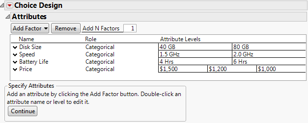

Select DOE > Consumer Studies > Choice Design.
Click the Choice Design red triangle and select Load Factors.
Figure 18.4 Choice Design Window with Attributes Defined
Click Continue.

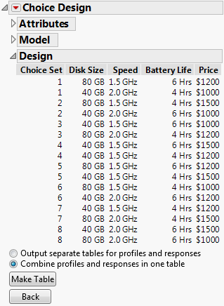

Click Make Design.
Note: Because choice designs are constructed using a random starting design, your design will likely differ from the one in Figure 18.5.
Figure 18.5 Pilot Design
Verify that the Combine profiles and responses in one table option is selected.
Click Make Table.
