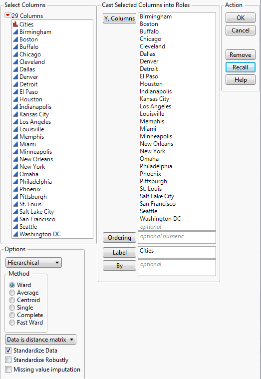

Select Help > Sample Data Library and open Flight Distances.jmp.
Select Analyze > Clustering > Hierarchical Cluster.
In the list at the bottom left corner of the launch window, change Data as usual to Data is distance matrix.
Select Cities and click Label.
Figure 11.6 Completed Distance Matrix Launch Window

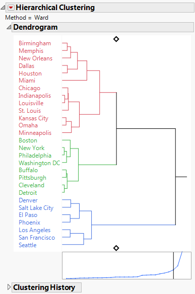

Figure 11.7 Dendrogram Report for Flight Distances
Figure 11.7 shows the Dendrogram report for the flight distances. The placement of the diamonds indicates that the model has grouped the cities into three clusters, which are color-coded on the dendrogram. For more details about how to interpret the report, see Dendrogram Report.
