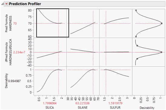

Select Optimization and Desirability > Maximize Desirability to find the optimum factor settings for our target value of HARDNESS.
We get the following Prediction Profiler display. Notice that the SILICA factor’s optimum value is on a sloped part of a profile curve. This means that variations in SILICA are transmitted to become variations in the response, HARDNESS.
Figure 3.20 Maximizing Desirability for HARDNESS

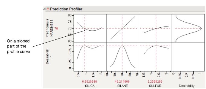

Now, we would like to not just optimize for a specific target value of HARDNESS, but also be on a flat part of the curve with respect to Silica. So, repeat the process and add SILICA as a noise factor.
Select Graph > Profiler.
Click OK.
5.
Change the Pred Formula Hardness desirability function as before.
6.
Select Optimization and Desirability > Maximize Desirability to find the optimum values for the process factor, balancing for the noise factor.
This time, we have also hit the targeted value of HARDNESS, but our value of SILICA is on its flatter region. This means variation in SILICA does not transmit as much variation to HARDNESS.
Figure 3.22 Maximize Desirability

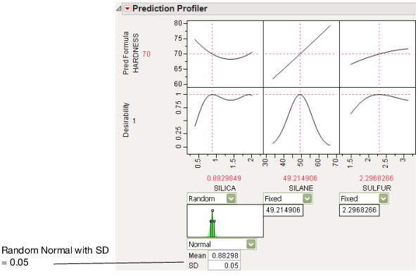

Select Simulator from the platform menu.
Assign SILICA to have a random Normal distribution with a standard deviation of 0.05.
Figure 3.23 Setting a Random Normal Distribution

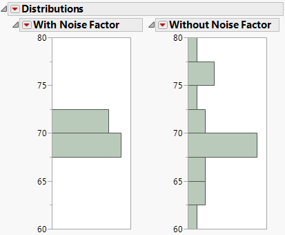

When the histograms appear, select Uniform Scaling from the Distribution main title bar.
The histograms show that there is much more variation in Hardness when the noise factor was not included in the analysis.

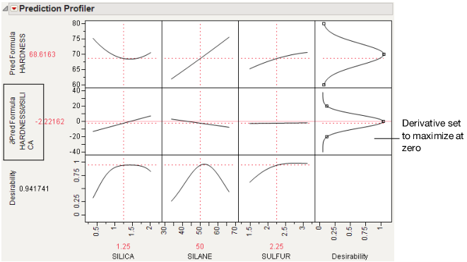

It is also interesting to note the shape of the histogram when the noise factor was included. In the comparison histograms above, note that the With Noise Factor distribution has data trailing off in only one direction. The predictions are skewed because Hardness is at a minimum with respect to SILICA, as shown in Figure 3.25. Therefore, variation in SILICA can make only HARDNESS increase. When the non-robust solution is used, the variation could be transmitted either way.
