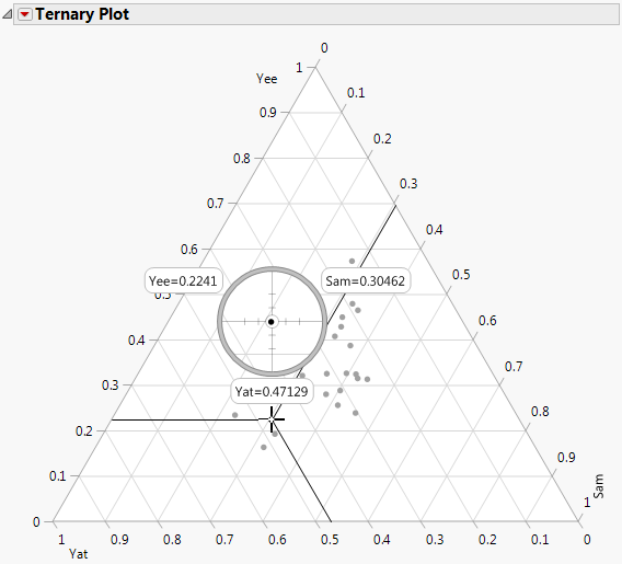

Figure 13.2 Example of a Ternary Plot
Figure 13.3 Using the Crosshairs Tool

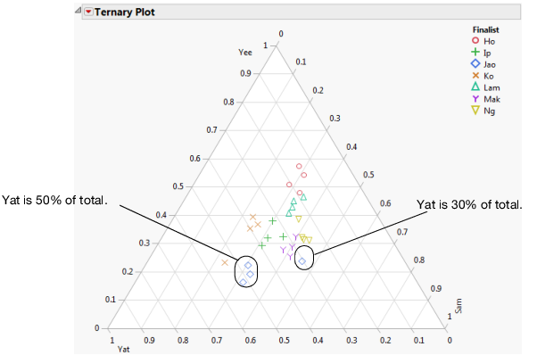

Right-click on the plot and select Row Legend.
Select Finalist in the column list box.
Colors should be automatically set to JMP Default.
Click OK.
Figure 13.4 Pogo Data Colored by Finalist
