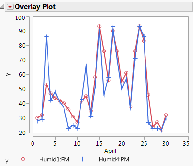

The plot shown in Figure 5.2 appears. Initially, this platform overlays all specified Y columns. The legend below the plot shows individual markers and colors that identify each Y column.
Figure 5.2 Plot with Legend
To help you quickly differentiate between the Ys, select Y Options > Connect Points from the Overlay Plot red triangle menu. Adjacent points are connected for each Y variable, as shown in Figure 5.3.
Figure 5.3 Plot with Connected Points
