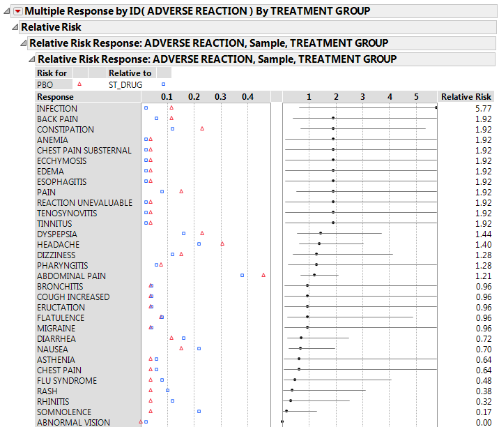

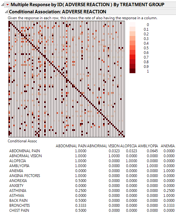

This example uses the AdverseR.jmp sample data table, which contains adverse reactions from a clinical trial. Use this data to explore the conditional association of adverse events and then the relative risk of the events in the treatment group as compared to the control.

Click the Categorical red triangle menu and select Conditional Association.
Figure 3.14 Conditional Association Report (Partial Report)

Click the Categorical red triangle menu and select Relative Risk.
9.
10.
Right-click the Relative Risk Report in the window and select Sort by Column.
11.
Figure 3.15 Relative Risk Report (Partial Report)
Right-click and select Columns > Lower 95% and Columns > Upper 95% to add 95% confidence intervals on the relative risk estimates to the report table.
