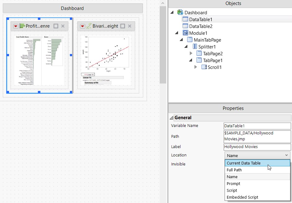

From any JMP window, select File > New > Dashboard.
In Dashboard Builder, select the 2 x 1 Dashboard template.
By default, this graph uses whatever data table is the current data table. In this example, Hollywood Movies.jmp stored in the Samples/Data folder is the current data table.
7.
Select Reference table by name to make sure the specified data table is always used to create the graph.
8.
Click OK.
In this example, Hollywood Movies.jmp in the Samples/Data folder will always be used as the current data table for the first graph, despite the current data table that is open.
Select Show Properties from the Dashboard Builder red triangle menu.
Figure 11.17 The Objects and Properties Panes
In the Objects pane, select DataTable1.
