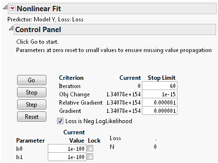

The Logistic w Loss.jmp data table in the Nonlinear Examples sample data folder has an example for fitting a logistic regression using a loss function. The Y column contains ones for events and zeros for non-events. The Model Y column has the linear model, and the Loss column has the loss function. In this example, the loss function is the negative log-likelihood for each observation, or the negative log of the probability of getting the observed response.
Select Analyze > Specialized Modeling > Nonlinear.
Figure 13.11 Nonlinear Launch Window
5.
Click OK.
Figure 13.12 Nonlinear Fit Control Panel
6.
Click Go.
Figure 13.13 Solution Report
