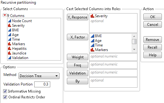

Select Analyze > Predictive Modeling > Partition.
For JMP, enter 0.3 as the Validation Proportion.
6.
Click OK.
