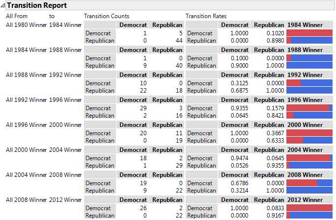

This example uses the Presidential Elections.jmp sample data table, which contains United States presidential election results for each state from 1980 through 2012. Use this data to explore Repeated Measures where we consider the election results the repeated measures.
1.
Select Help > Sample Data Library and open Presidential Elections.jmp.
2.
Select Analyze > Consumer Research > Categorical.
3.
Select 1980 Winner through 2012 Winner.
4.
On the Related tab, click Repeated Measures.
5.
Figure 3.17 Repeated Measures Transition Report
