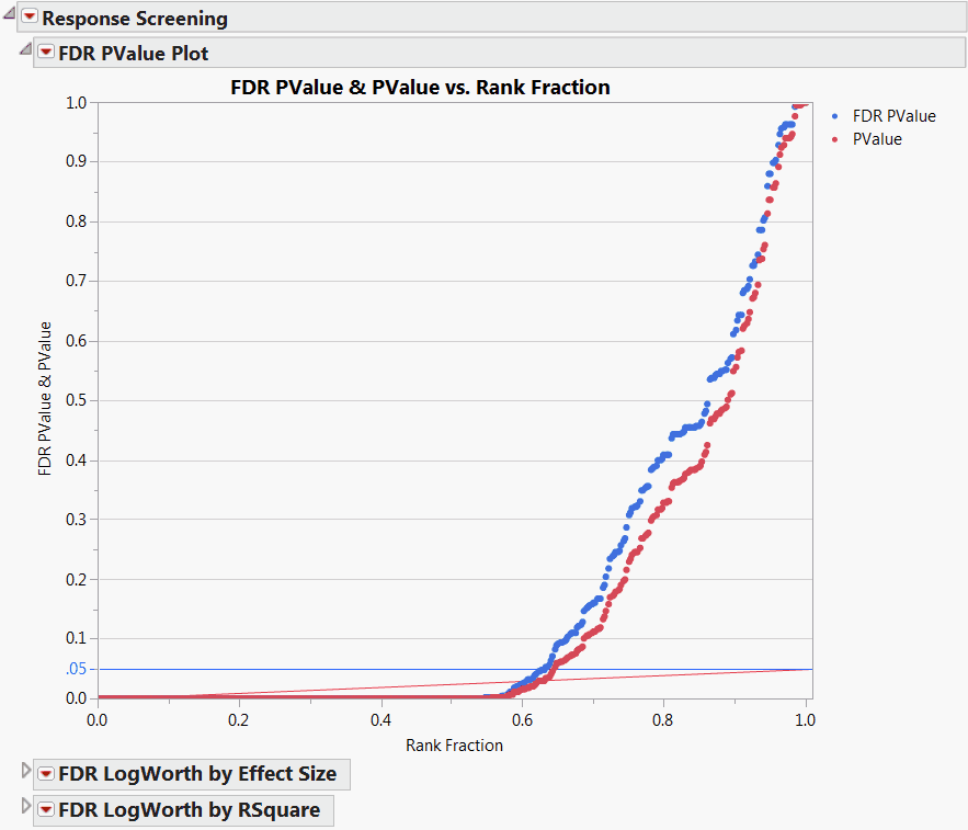

The Response Screening report appears, along with a data table of supporting information. The report (Figure 18.2) shows the FDR PValue Plot, but also contains two other plot reports. The table contains a row for each of the 387 columns that you entered as Y, Response.
The FDR PValue Plot shows two types of p-values, FDR PValue and PValue, for each of the 387 tests. These are plotted against Rank Fraction. PValue is the usual p-value for the test of a Y against Process. The FDR PValue is a p-value that is adjusted to guarantee a given false discover rate (FDR), here 0.05. The FDR PValues are plotted in blue and the PValues are plotted in red. The Rank Fraction ranks the FDR p-values from smallest to largest, in order of decreasing significance.
Both the horizontal blue line and the sloped red line on the plot are thresholds for FDR significance. Tests with FDR p-values that fall below the blue line are significant at the 0.05 level when adjusted for the false discovery rate. Tests with ordinary p-values that fall below the red line are significant at the 0.05 level when adjusted for the false discovery rate. In this way, the plot enables you to read FDR significance from either set of p-values.
The FDR PValue Plot shows that more than 60% of the tests are significant. A handful of tests are significant using the usual p-value, but not significant using the FDR p-value. These tests correspond to the red points that are above the red line, but below the blue line.
