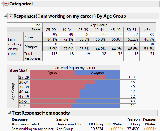

This example uses the Consumer Preferences.jmp sample data table, which contains survey data on people’s attitudes and opinions, and questions concerning oral hygiene. You can use the categorical platform to compare the response to a question by age groups.
Select Analyze > Consumer Research > Categorical.
5.
Click OK.
6.
Click the Categorical red triangle and select Crosstab Transposed.
7.
Click the Categorical red triangle and select Test Response Homogeneity.
Figure 3.2 Question Responses by Age Group
