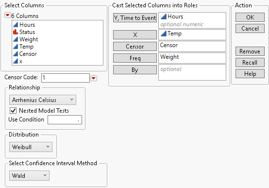

Select Analyze > Reliability and Survival > Fit Life by X.
5.
6.
Leave the Censor Code as 1.
7.
8.
9.
Select Weibull as the distribution.
10.
Keep Wald as the confidence interval method.
Figure 4.2 shows the completed launch window.
Figure 4.2 Fit Life by X Launch Window
11.
Click OK.

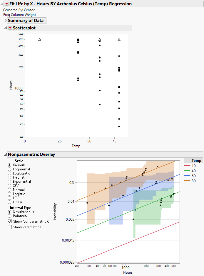

Figure 4.3 shows the top half of the Fit Life by X report window.
