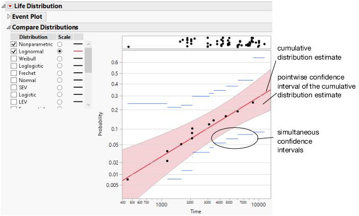

In the Compare Distribution report, select Lognormal distribution and the corresponding Scale radio button.
Figure 3.2 Probability Plot

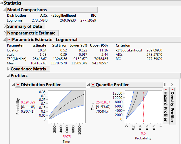

Below the Compare Distributions report, the Statistics report appears (Figure 3.3). This report provides a Model Comparison report, nonparametric and parametric estimates, profilers, and more.
Figure 3.3 Statistics Report
