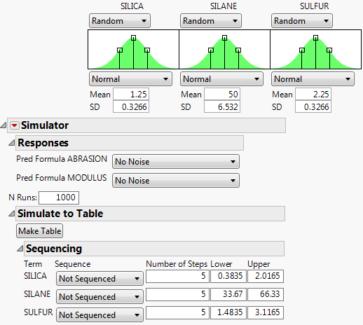

Select Pred Formula ABRASION and Pred Formula MODULUS and click Y, Prediction Formula.
Change the N Runs value to 1000.
Figure 8.2 Simulator Settings

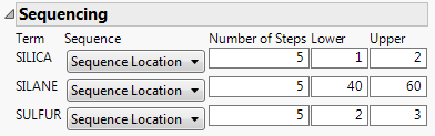

For SILICA, select Sequence Location. Leave the number of steps set to 5. Set the Lower limit to 1 and the Upper limit to 2.
10.
For SILANE, select Sequence Location. Leave the number of steps set to 5. Set the Lower limit to 40 and the Upper limit to 60.
11.
For SULFUR, select Sequence Location. Leave the number of steps set to 5. Set the values Lower limit to 2 and the Upper limit to 3.
Figure 8.3 Sequencing Settings
12.

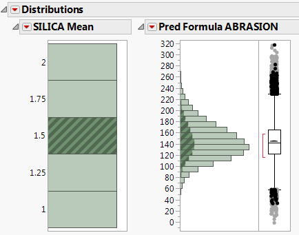

13.
14.
Select SILICA Mean and Pred Formula ABRASION and click Y, Columns.
15.
Figure 8.4 Distribution of SILICA Mean by Pred Formula ABRASION
Click a histogram bar that corresponds to a SILICA Mean to see how the predicted value for abrasion varies across the simulated silane and sulfur ranges given the selected value of silica.
