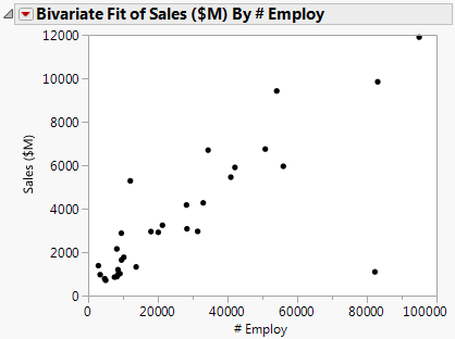

This example uses the Companies.jmp sample data table, which contains financial data for 32 companies from the pharmaceutical and computer industries.
5.
Click OK.
Figure .2 Initial Scatterplot

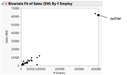

6.
8.
Select Rows > Exclude/Unexclude. The point is excluded from the analysis and the scatterplot is automatically updated.
Figure .3 Updated Scatterplot

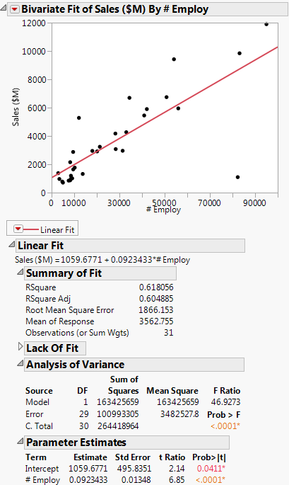

9.
Fit a regression line by selecting Fit Line from the red triangle menu. Figure .4 shows the regression line and analysis results added to the report window.
Figure .4 Regression Line and Analysis Results

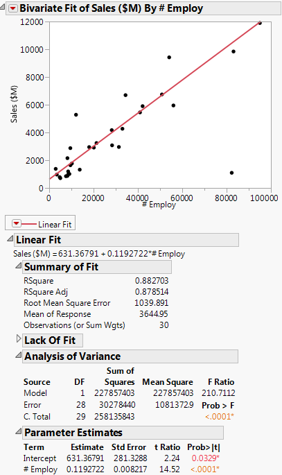

11.
Select Rows > Exclude/Unexclude. The regression line and analysis results are automatically updated, reflecting the exclusion of the point.
