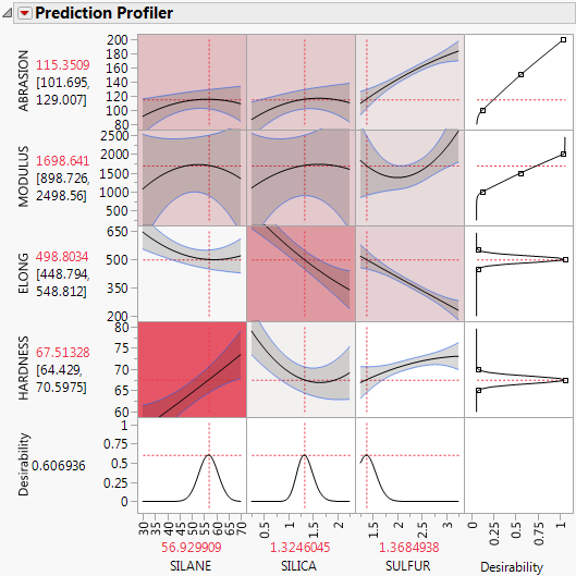

The report shows tables for each of the four responses. The Overall table averages the factor importance indices across responses. The factors in the Prediction Profiler (Figure 3.29) have been reordered to match their ordering on the Overall table’s Total Effect importance.

Colors from a red to white intensity scale are overlaid on profiler panels to reflect Total Effect importance. For example, you easily see that the most important effect is that of Silane on Hardness.
Figure 3.29 Prediction Profiler for Four Responses

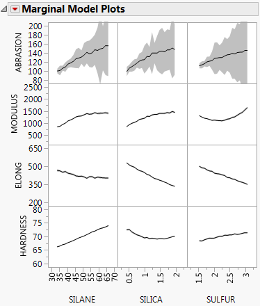

The Marginal Model Plots report (Figure 3.30) shows mean responses for each factor across a uniform distribution of settings for the other two factors.
Figure 3.30 Marginal Model Plots for Four Responses
