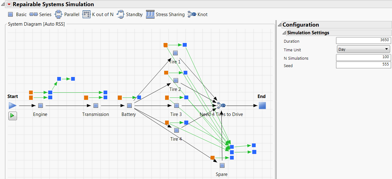

Select Help > Sample Data, click Open the Sample Scripts Directory, and open Car Repair Simulation.jsl.
Figure 12.2 Car Repair System Diagram

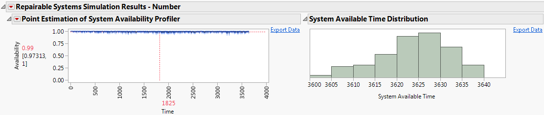

A window appears containing the Repairable Systems Simulation Results report. For more information about how to interpret these results, see Repairable Systems Simulation Results.
Figure 12.3 Partial RSS Report

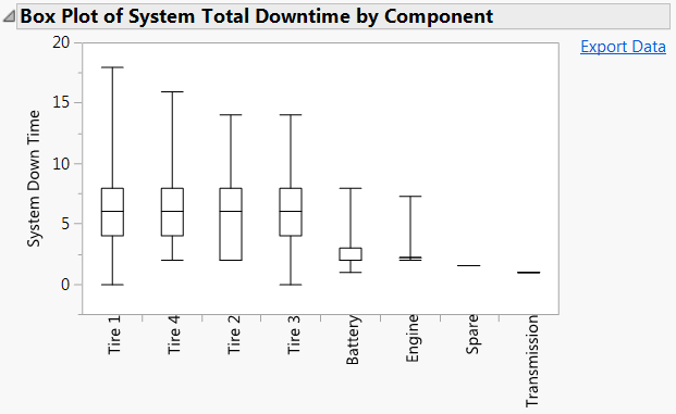

Click the red triangle next to Repairable Systems Simulation Results - Number and select Box Plot of Total System Downtime by Component.
