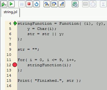

Figure 4.11 Set the Breakpoint
Click Run.

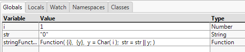

Figure 4.13 Global Variables at First Breakpoint
5.
Click Run again.
stringFunction() is called, evaluated, and returns to the loop.
i is incremented and determined to be less than or equal to 9.

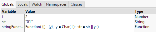

Figure 4.14 Global Variables at Second Breakpoint
You can continue to click Run and watch i and str change with each iteration of the loop. Or, click Run without breakpoints to complete running the script and exit the Debugger.

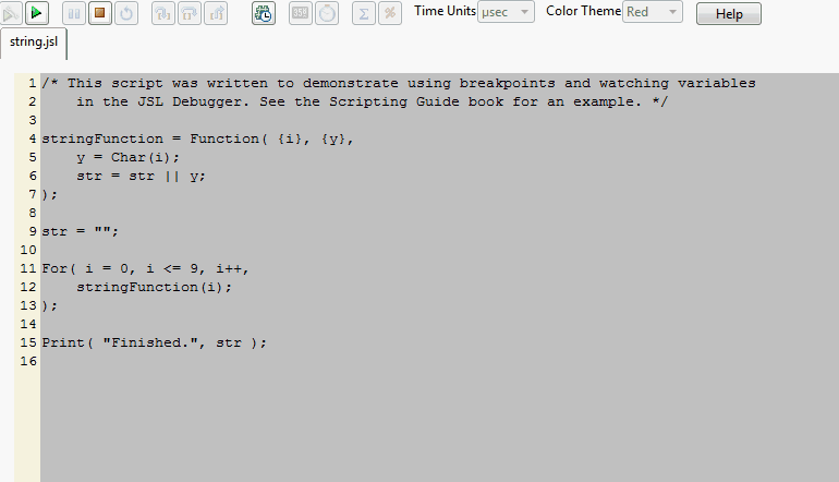

Figure 4.15 Initial JSL Profiler Window

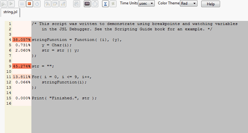

Figure 4.16 Profiled Script Window
In the left margin, the selected statistics are displayed. Percent of time is displayed by default. Click the Show Profile by Count button
to switch to percent of statement counts instead. The left margin is color-coded to allow for quick identification of problematic performance areas.
