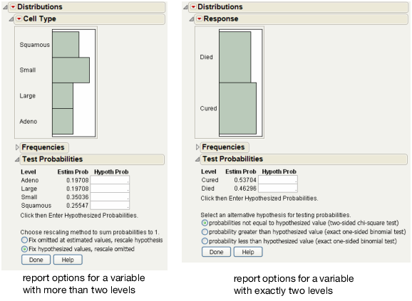

From the red triangle menu next to Cell Type, select Test Probabilities.
See Figure 3.15 at left.

From the red triangle menu next to Response, select Test Probabilities.
See Figure 3.15 at right.
Figure 3.15 Examples of Test Probabilities Options
Refer to Figure 3.15 at left. Type 0.25 in all four Hypoth Prob fields.
Click the Fix hypothesized values, rescale omitted button.
Click Done.
Refer to Figure 3.15 at right. Type 0.5 in both Hypoth Prob fields.
Click the probability less than hypothesized value button.
Click Done.

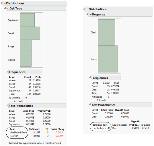

Figure 3.16 Examples of Test Probabilities Reports
