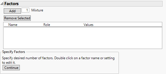

Figure 13.4 Factors Outline
The name of the factor. When added, a factor is given a default name of X1, X2, and so on. To change this name, double-click it and enter the desired name.
To edit a value, click the value in the Values column.
