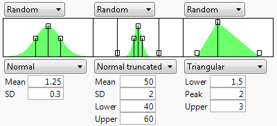

Draws a random value of the factor for each simulation run from the specified distribution and distributional parameters. When you select Random, distribution options appear. For more information about the options, see Continuous Factors and Categorical Factors.
Figure 8.5 Example of Three Random Distributions
Max(0,RandomNormal(5,2))
After entering the expression, click the Reset button to submit the expression.
