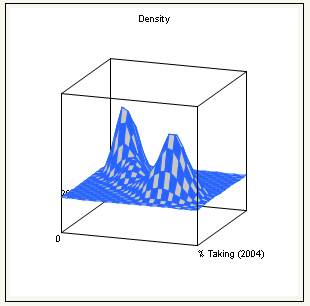

Is a three-dimensional plot of the density over a grid of the two analysis variables. See Figure 5.17.
Figure 5.17 Example of a Mesh Plot
