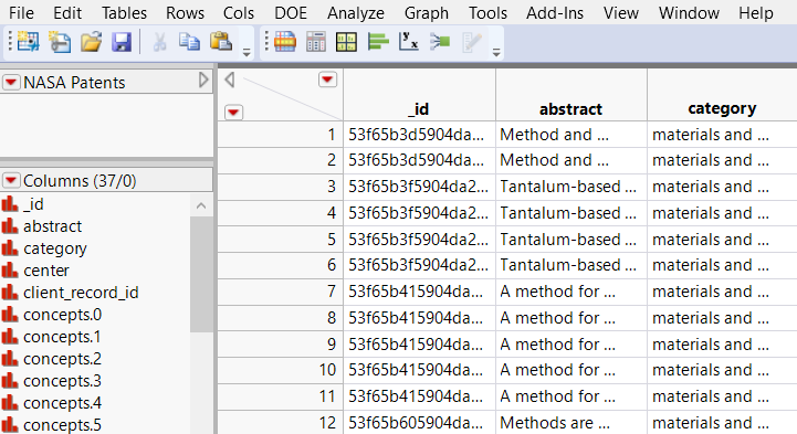

key= "<key>"; // substitute your key
limit = 100;
url = "https://api.nasa.gov/patents/content";
request = New HTTP Request(
URL( url ),
Method( "Get" ),
Query String(
[["api_key" => key, "concept_tags" => "false",
"limit" => limit]]
json = request << Send();
jsl_json = Parse JSON( json );
dt = JSON To Data Table( As JSON Expr( jsl_json["results"] ) );
// JSON to Data Table turns JSON data into a data table
// As JSON Expr turns a JSL associative array into a JSON string
dt << Set Name( "NASA Patents" );
Figure 14.5 Data Imported in a Data Table
