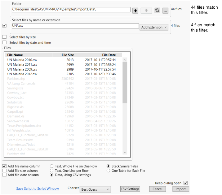

Browse to select the JMP Samples/Import Data folder.
Specify multiple file names and extensions by separating them with semicolons, or click Add Extension and select an extension.
Figure 3.53 Selected CSV Files
(Optional) In the Select files by size box, type the lower and upper file size limits.
(Optional) In the Select files by date and time box, click the calendar button
to specify the date and time range of the files that you want to import. |
(Unstructured text files) Select Text, Whole File on One Row or Text, One Line Per Row based on how the file is structured.
(CSV files) Select Data, Using CSV Settings to import a comma-delimited file.

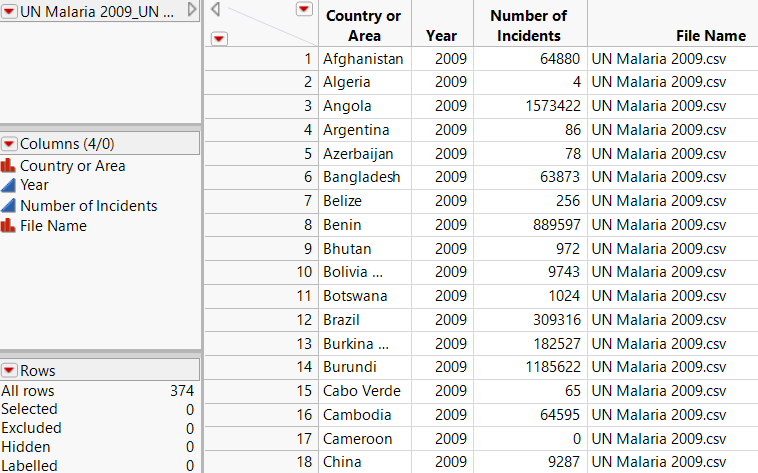

Keep Stack Similar Files selected because these CSV files have the same columns.

Click Import.
Figure 3.54 Imported CSV Data
Keep dialog open is off by default, but you might turn it on while testing. This enables you to import files to see what the data looks like, edit the source files if necessary, and reimport them with the same settings.
