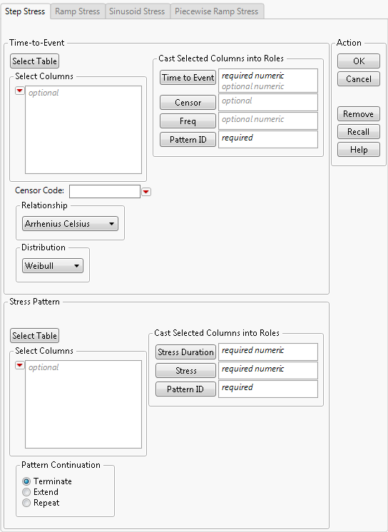

Launch the Cumulative Damage platform by selecting Analyze > Reliability and Survival > Cumulative Damage. You must supply the Cumulative Damage platform with two data tables as input. The first data table is time-to-event data for each unit under test. The second data table defines the stress patterns used for each unit.
Figure 5.5 The Cumulative Damage Launch Window
