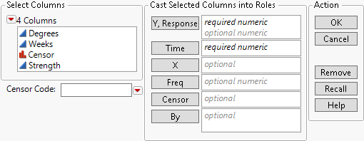

Launch the Destructive Degradation platform by selecting Analyze > Reliability and Survival > Destructive Degradation. Figure 8.10 shows the Destructive Degradation launch window using the Adhesive Bond.jmp data table (located in the Reliability folder).
Figure 8.10 The Destructive Degradation Launch Window
Identifies the column containing the degradation measurements. When your response values are interval-censored, you can enter two columns. See Specify Two Y Columns.
