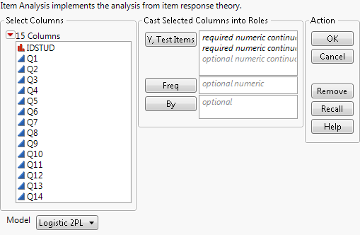

Launch the Item Analysis platform by selecting Analyze > Multivariate Methods > Item Analysis.
Figure 10.4 Item Analysis Launch Window

The Item Analysis platform requires a data table that contains a row for each individual and a column for each item. The item columns must be numeric and contain only 0s and 1s to indicate incorrect or correct responses, respectively. The MathScienceTest.jmp sample data table illustrates the required data format for an item response analysis of 1,263 individuals responses to 14 test questions.
