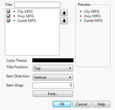

Change certain aspects of the graphic elements (line, bars, and so on) such as color, fill, transparency, and gradient. You can also add a title to the legend. See Legend Settings Window.
To move the position of the legend, click the Graph Builder red triangle and select Legend Position. The legend appears on the right by default, but you can move it to the bottom of the graph, or inside the graph on the left or right.
Select a different color theme. For details about color themes, see Create Color Themes in the Using JMP book.

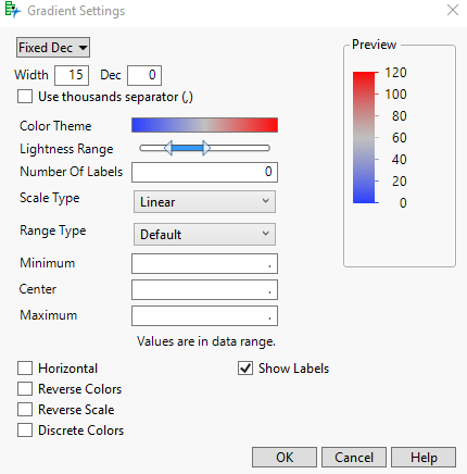

Figure 3.46 Gradient Settings Window
To format the labels in the legend, use the menu, Width and Dec boxes, and the Use thousands separator (,) check box in the top left of the window.
Change the color theme or define a custom color theme. For more details about color options, see Create Color Themes in the Using JMP book.
The minimum and maximum values are the 5th and 95th quantiles, or they are the values that you specify as Minimum and Maximum. This option is resistant to outliers.
