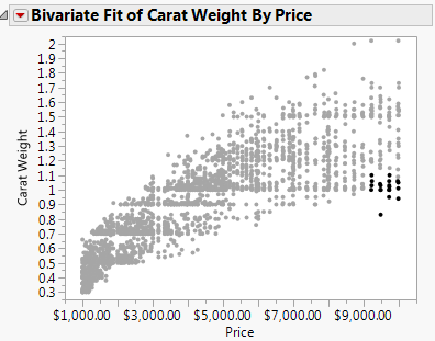

Select Analyze > Fit Y by X.
5.
Click OK.
6.
Select Tools > Lasso.
8.
In the data table, select Rows > Next Selected (or you can press the F7 key).
Figure 4.8 Points Selected
