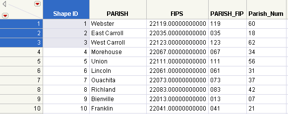

In the Parishes file, add a new column. Name it Shape ID. Drag and drop it to be the first column.
In the first three rows of the Shape ID column, type 1, 2, and 3 (Note - You can also use Cols > New Columns > Initialize Data > Sequence Data).
Select all three cells, right-click, and select Fill > Continue sequence to end of table.
Figure 15.20 Shape ID Column in Parishes File

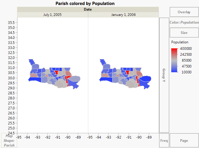

Select Graph > Graph Builder.
7.
Drag and drop Parish into the Map Shape zone.
The map appears automatically, since you defined the Parish column using the custom map files.
8.
Drag and drop Population into the Color zone.
9.
Drag and drop Date into the Group X zone.
Figure 15.21 Population of Parishes Before and After Katrina

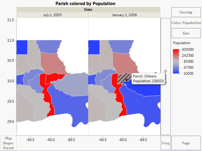

Select the Magnifier tool to zoom in on the Orleans parish in both maps (see Figure 15.22)
Figure 15.22 Orleans Parish

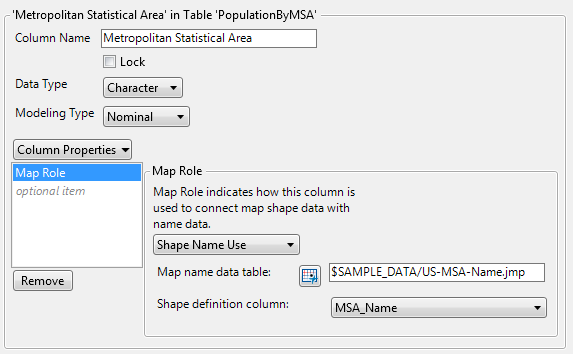

Right-click the Metropolitan Statistical Area column and select Column Info.
Select Column Properties > Map Role.
Select Shape Name Use.
5.
Next to the Map name data table, type $SAMPLE_DATA/US-MSA-Name.jmp.
6.
Select MSA_Name from the Shape definition column list.
MSA_Name is the specific column within the US-MSA-Name.jmp data table that contains the unique names for each metropolitan statistical area. Notice that the MSA_Name column has the Shape Name Definition Map Role property assigned, as part of correctly defining the map files.
Note: Remember, the Shape ID column in the -Name data table maps to the Shape ID column in the -XY data table. This means that indicating where the -Name data table resides links it to the -XY data table, so that JMP has everything that it needs to create the map.
Figure 15.23 Map Role Column Property

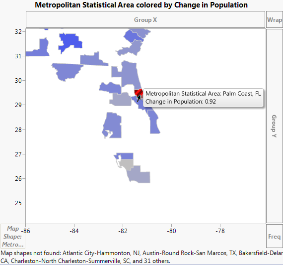

Select the Magnifier tool to zoom in on the state of Florida.
5.
Select the Arrow tool and click on the red area.
Figure 15.25 Population Change of Palm Coast, Florida

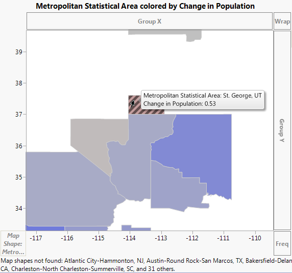

Select the Magnifier tool and zoom in on the state of Utah.
8.
Select the Arrow tool and click on the area that is slightly red.
Figure 15.26 Population Change of St. George, Utah
