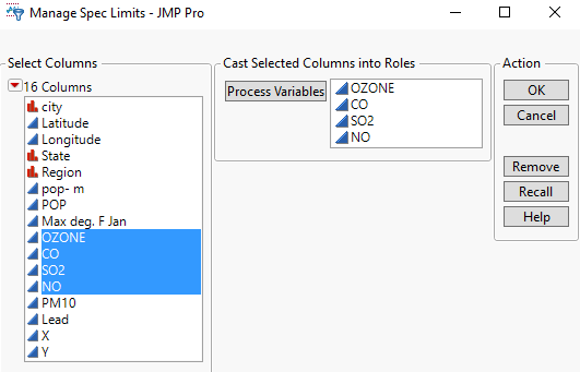

Select Help > Sample Data Library and open Cities.jmp.
Select Analyze > Quality and Process > Manage Spec Limits.
Figure A.1 Specify Columns

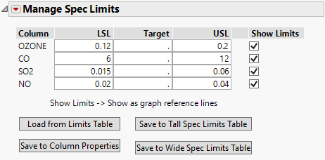

Add your specification limits. You can do this by loading existing limits from a JMP data table (Load from Limits Table) or by entering limits manually. For this example, enter the following limits manually:
OZONE: LSL 0.12, USL 0.2
CO: LSL 6, USL 12
SO2: LSL 0.015, USL 0.06
NO: LSL 0.02, USL 0.04
Figure A.2 Set Specification Limits
7.
Choose how you want to save the specification limits. For this example, click Save to Column Properties. This saves them as column properties in the corresponding data table. You could also save them to a new data table (tall or wide format).

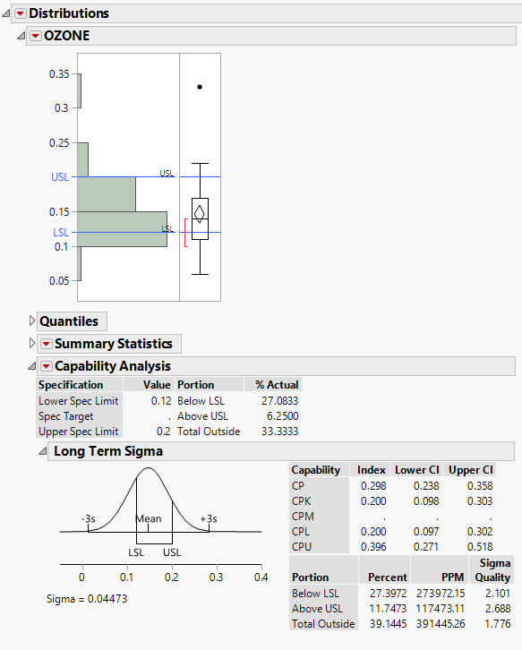

Select OZONE, CO, SO2, and NO, and click Y, Columns.
11.
Figure A.3 Specification Limits for OZONE in Distribution
The specification limits that you added to the OZONE column appear in the histogram. Because the column contains a Spec Limits column property, the Distribution report also contains a Capability Analysis report.
