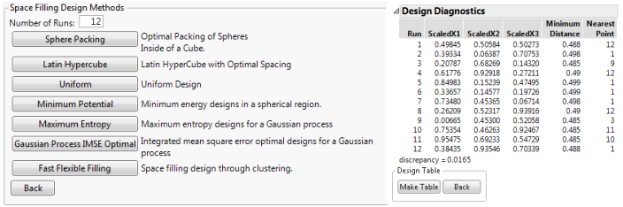

In the design specification dialog (shown on the left in Figure 21.18), enter a sample size (Number of Runs). This example uses a sample size of 12.
6.
Click the Minimum Potential button. JMP creates this design and displays the design runs and the design diagnostics (shown on the right in Figure 21.18).
Figure 21.18 Space-Filling Methods and Design Diagnostics for Minimum Potential Design

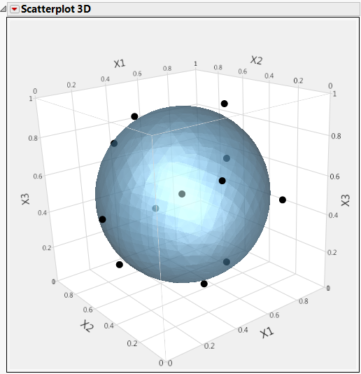

In the Scatterplot 3D launch dialog, select X1, X2, and X3 as Y, Columns and click OK to see the initial three-dimensional scatterplot of the design points.
Right-click on the plot and select Settings, and then increase the marker size using the Marker Size slider.
Figure 21.19 Minimum Potential Design Points on Sphere
