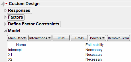

When the Model outline opens, for most factors only the main effects appear. If you have entered a discrete numeric factor, polynomial terms also appear. The Estimability of second-and higher-order terms is set to If Possible. If you want to ensure that these terms are estimable, change their Estimability to Necessary.
Note: You can ensure that the estimability of discrete numeric polynomial terms is always set to Necessary. Select File > Preferences > Platforms > DOE. Check Discrete Numeric Powers Set to Necessary.
Figure 4.21 Model Outline
The Bayesian D-Optimal design approach obtains precise estimation of all Necessary terms while providing omnibus detectability (and some estimability) for If Possible terms. For more detail, see Response Surface Experiments in Examples of Custom Designs and Bayesian D-Optimality.
